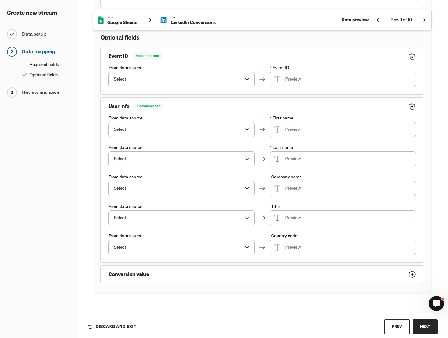

Step 2: Set up data mapping
In this step, you define which data you want to stream from your configured data source to the destination.
  1. Using the dropdown menus, select the appropriate columns from your data source to map them with the destination fields. For example, select the column that contains the event timestamp to map it with the destination timestamp field.
  2. Add optional columns by clicking the available optional field groups. Proceed to map individual fields similarly as in step 1.
    It's recommended to include Event ID as an optional field to avoid duplicates. User info (First name and last name) are also recommended fields that help matching the data.
  3. Preview the data using the arrows at the top. You will see a preview from the source data in the interface. Check for any validation errors. You can browse up to ten rows of the preview data to check for discrepancies.
  4. Once you have mapped all the data fields you wish to send to the destination, click Next.
