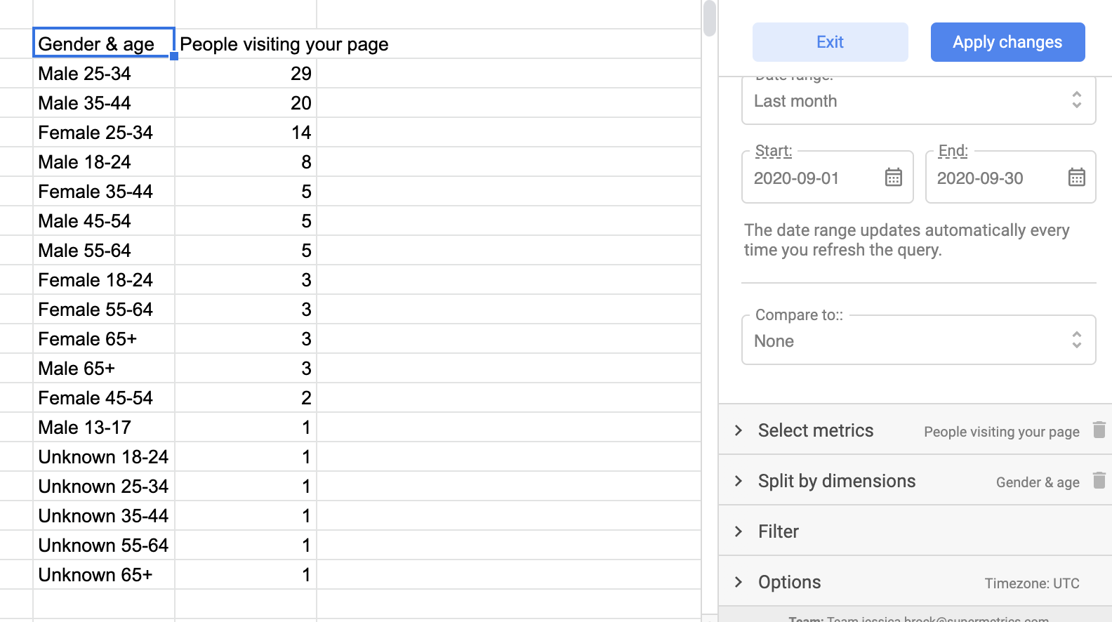

  • Oops - this was fixed some time ago and we didn't reply back!
    Specifically "page_views_by_age_gender_logged_in_unique" was the broken one, which we call "People visiting your page". "Total page views" is not supported by the API, I apologize I used field name, it should be the unique version which is "People visiting your page", split by the demographic dimensions. For example "Gender & Age", as shown here:
    -Thank you
