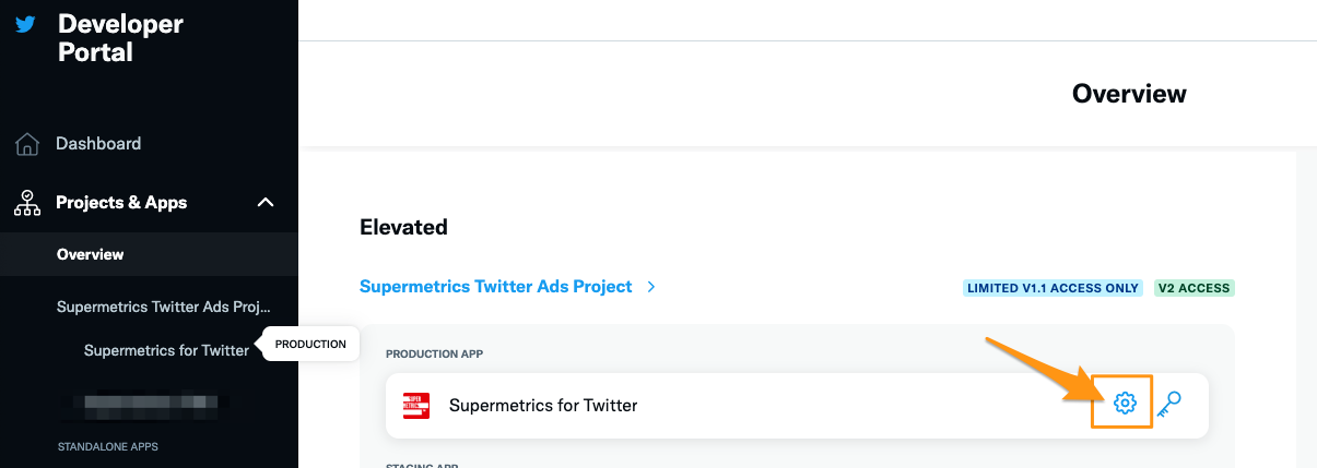

Step 3: Get your API keys
Once your Enterprise subscription is activated, you can configure your app and gather the API keys needed to log in later.
  1. Go back to your Twitter developer portal.
  2. You should see at least one project and one project app. This project should be under "Elevated" to show it has Enterprise API access.
  3. On the project app, click the cog-icon to open the app settings.
  4. Under User authentication settings, click Edit.
  5. Set App permissions to "Read".
  6. Leave Type of App unchecked.
  7. Under App info:
    1. Set the Callback URI / Redirect URL to https://supermetrics.com/login-complete/.
    2. Set Website URL to your own website.
    3. Set the Organization name to your own company name.
    4. The rest are optional and can be skipped if you wish.
  8. Click Save.
  9. Back on the Settings page, go to the Keys and tokens tab.
  10. Under the Consume Keys section, click Regenerate.
  11. You'll get a popup with your API key and API key secret. Copy them for later use — these two values are needed to log in to the Twitter Premium data source.
